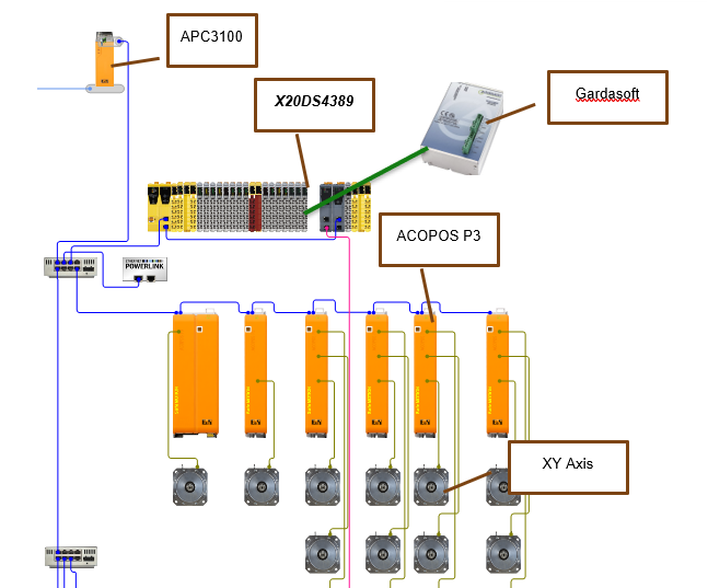

I would like to use the Axis feature “Signaling” to trigger a camera system. The mechanical setup consists of a gantry in which the X and Y axes are designed as an XY CNC system:
I have configured the 2-Axes CNC (XY) according to the help, as well as the Signaling feature.
In addition, I also had to add the M-Functions feature to the axis group (which is not mentioned in the help) as otherwise a corresponding error would be output when the CNC program is executed.
I tried to trigger the camera with a simple program, the number of triggers is correct but the timing does not fit at all:

The variable ::FG_VB:diTimeStamp is incremented correctly, but it does not match the current NetTime of the SoC at all:
I would have expected the generated NetTimestamp to be calculated by the “Signaling” feature based on the NetTime of the SoC, but this does not seem to be the case.
Which settings are missing?
The timestap does seem ok but something is wrong with the prediction.
Simon
can anyone help @simon.buschor?
Well, the whole process wasn’t easy, especially since the NetTime module has countless settings. The main issue, however, was the override on the MpCnc2Axis FUB, which was set to 60. Since the Signaling feature doesn’t have access to this value, the prediction is calculated using an override of 100.
The feedrate used in the CNC program is written in the PlcTask and is calculated with a different override. That was the solution.
