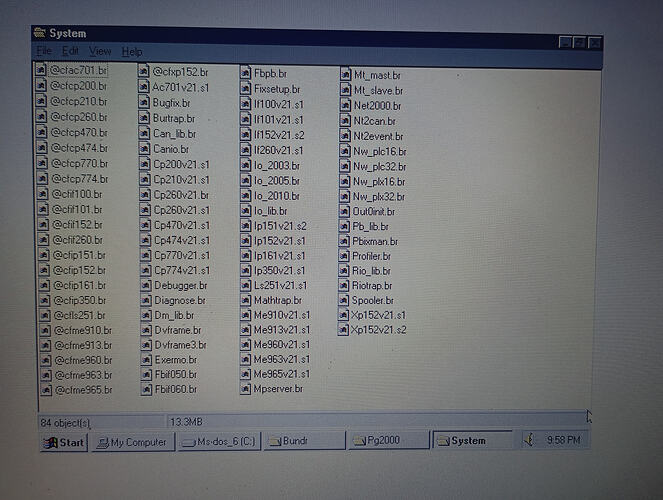

Hi Alexander.
Look how curious… I accessed the System folder and, as you said, there are files that start with @ and end with *br, and also files that end in *s1. As shown in the image, the System folder contains the .br files for all the CPUs, EXCEPT for the CP476, which is precisely the CPU model I need.
Not wanting to accuse anyone, but is it possible that the machine manufacturer may have intentionally deleted this file so that it would be necessary to request a paid service to have the program installed?
Or does this file installed during the PG2000 software is installed on the computer? Could it be a software installation error?
I’m really confused now.
Kind regards.
I don’t think/hope that the files where intentionally removed - sure, nothing is impossible, but providing the project source but deleting the operating system files doesn’t seem to be a “clever way” to protect after-sales business :wink:
About the installation I can remember that it have been two different setups:
  • the disk-set with the PG2000 setup
  • another disk-set with the Operating Systems
So it was possible to add/install newer/different operating system version support into existing PG2000 installations.
What I can conclude out of the screenshot (thanks for that!) is, that the operating system version for all of the installed PLCs is V2.10.
For CP476, V2.10 has never been existing, as this PLC type was developed later then V2.10 was released… so I don’t think it’s an installation failure or so, it just looks like that the installation packages where this installation is based on are older then the time when CP476 support was added to PG2000.
The CP476 was introduced almost near at the end of the PG2000 life-cycle, so I think the operating systems usable with CP476 were some versions >= V2.2x (I don’t remember the concrete numbers).

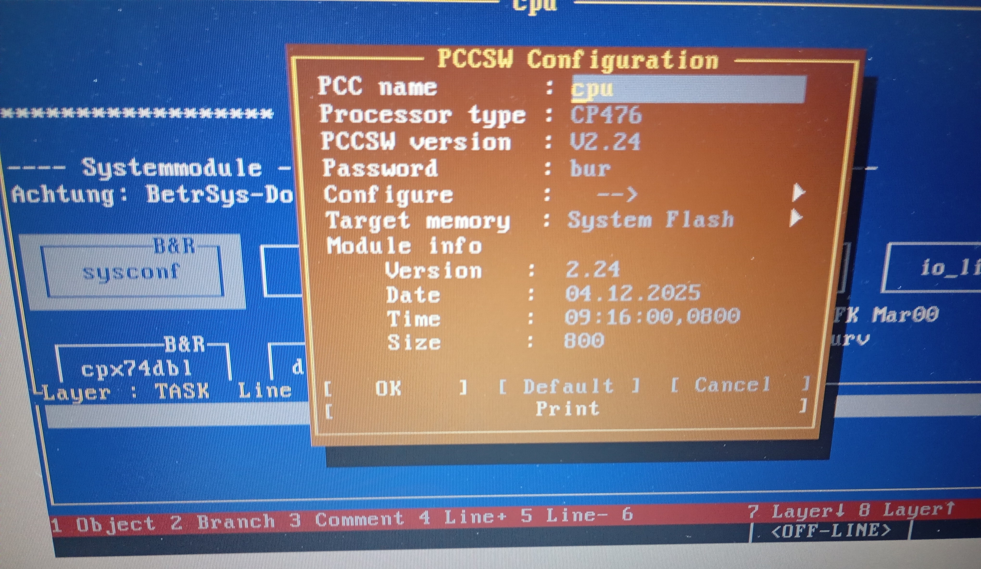

Hi Alexander.
As per the attached image, the sysconf library indicates that the PCCSW version is 2.24. All I have is the program installer.
I didn’t know there was a separate operating system disk. Could some of the more experienced colleagues clarify this for us? In that case, uninstalling and reinstalling the program won’t solve the problem, since the operating system is installed separately. Is there anything I could do in this situation?
Kind regards.
