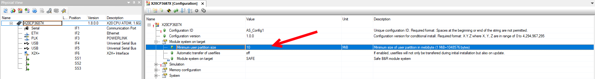

Since the newer Automation Studio Versions calculate the partition size for C:,D:,E: automaticaly. There is no setting for this size.
C: Runtime Storage
D: User Applikation + Installation Package Download location while Install
E: Mirror Partition for D
I think the main unknown is the user Partition size F: , but this can be set up by the user.
I am not aware of a Dialog in which you can read out the required size of a CF-Card.
But a rugh roule of thumb is 512 MB + User Partion Size .
As far as i know the Installation Package is a zip-Folder and therfore smaller than the unpacked data.
