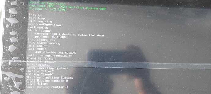

Hi
Now I am using 4ppc80-156b-10A panel pc .
I am also getting same error mentioned in topic but after i followed below steps.
  1. Created USB installation drive on D\:(Normal Sandisk–I did not make it as a bootable).
  2. Then inserted in C80 controller power restart –In boot manager -selected boot options sandisk pendrive––enter
  3. PP-C80-Installation boot window opened –100%
  4. Then other popup window opened —
  5. Then c80 controller screen is not coming.

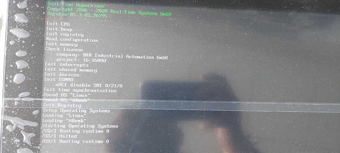

I don’t know what happened. fyr images are attached here
Please help me to resolve this issue.
You installed the program but the screen is not showing up?
Yes
Installed the program after below screen then screen is not on.
If your screen has power and is constantly black, you need to upgrade your screen version to 1.3.0 or 1.3.1. This issue existed in the older version. Can you try it?
Yes
afternoon did same thing
1. PPC80 latest firmware version —1.0.3.0 to 1.3.0.0
2. Automation Runtime version ---- D4.90 to O4.93
3. Mapp view version ---------------5.24.1 to 5.24.4
4. Transferred project directly from Laptop to PC.
Screen came.
