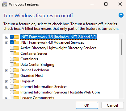

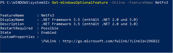

Older Versions of DTM require .NET 3.5
This can be checked with PowerShell command “Get-WindowsOptionalFeature -Online -FeatureName NetFx3”
It needs to show “State” → Enabled
.NET 3.5 can be enabled via the “Windows Features” settings.
Next restart your system.
Delete and reload the IODD file with the B&R tool IODD DTM Configurator.
Now, the errors should disappear.
