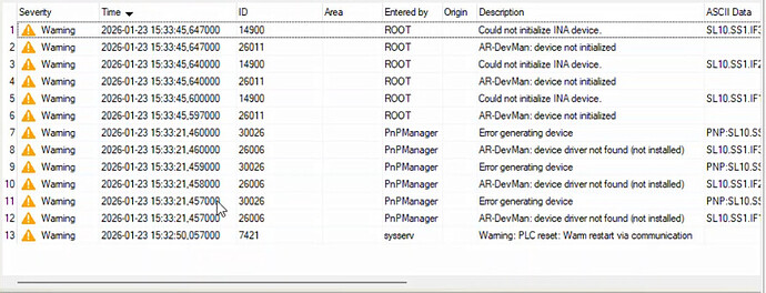

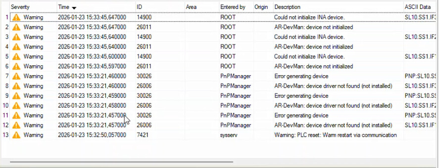

Error 8258 on FRM_xopen on 3IF060.6 :
In logger we can see :
We recently encountered a problem where a customer was making some modifications to a machine (System 2005), and suddenly the error 8258 started appearing on the originally running machine. The customer was modifying both HW and SW and we didn’t know how the error could have arisen.
The error behaved very randomly and strangely. After some replays it worked, after some it didn’t.
In the end, we figured out that it was because the Ddsfif6 driver was sometimes not in SW.
If you get this error, make sure you have Binary Object Ddsfif6 in SW tree. If not, Rebuild the project.
