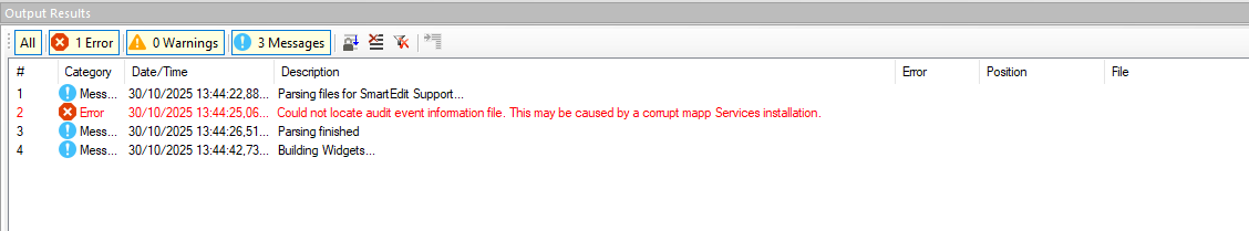

Error message in output results when opening project
When I open an project I get this error message.
I have re-installed Automation Studio and all the services but this doesn’t fix it. After build the project the message is gone. But when I open the project again the message is there again.
Does anyone know how this can be fixed?

I have the exact same issue. It doesn’t seem to affect my project since the error disappears after a build/rebuild and I can transfer my project to my PLC. But every time I open up my project, I get the same error.

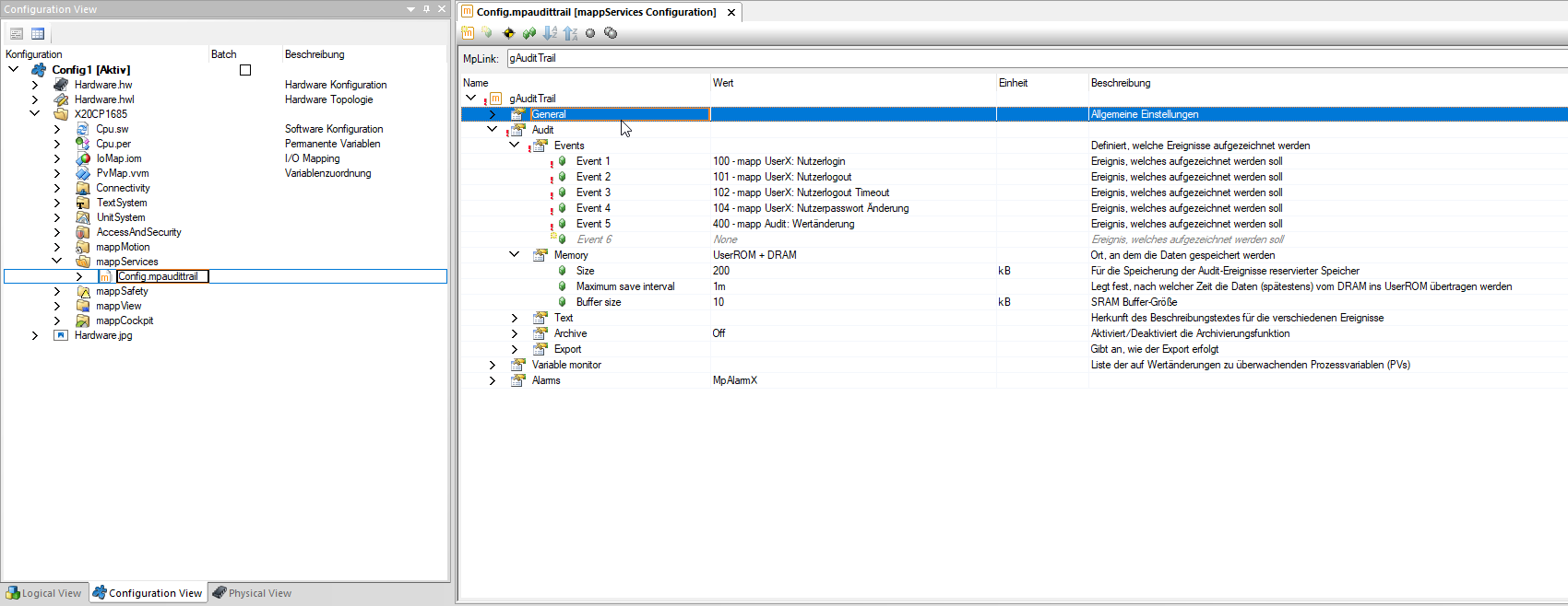

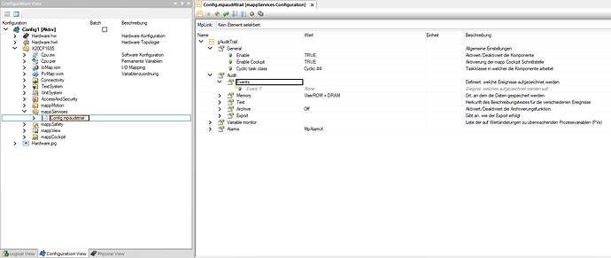

i have installed the version you mentioned and tried to reproduce the message.
It occurs as soon as i add the AuditTrail from the Toolbox.
After Reseting the Events to default, the error does not occure.
Going back to mappService 6.3, 6.0 the issue does occure, too.
My Collegue tried it on AS6.3.3 there it does not seam to happen.
I will make an offical report to B&R Support.
I got an Update from the Support.
The problem is known and a fix is planned for AS6.5.0 (planned release 2025-12-12, could change). Please consider an upgrade to the newer Version after its release.
