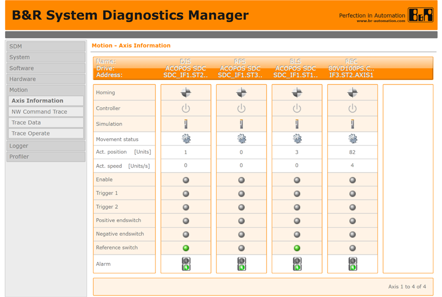

I’m trying to access the torque/current data of a servo motor in a system that uses an X20PC1584 CPU. I managed to connect to the CPU via Ethernet, and the Automation Studio is in “run” mode. Is it possible to read the torque data without having access to the source code? The system was installed a long time ago, and we don’t have access to the OEM.
The System Diagnostics Manager provides me with this general information.
even when you don’t have the code, you can create a new project with the hardware configured (only the axes you care about have to be inserted but must be on the correct node numbers) and the same ACP10 version as on the machine. You can then connect to the PLC and open the test window and read ParIDs (without replacing the PLC software).
ParID 277 would give you the current torque.

Hi Sina
Or using a trace configuration created locally uploading it to the running PLC on site with the SDM option “Trace Operate”. If you have no direct connection with the PLC.

Dear Michael,
Your instruction worked perfectly, and I’m seeing everything that I wanted in the Trace window.
