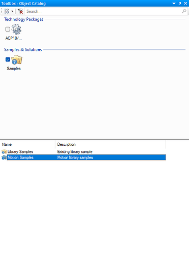

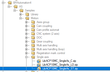

From the toolbox just import “Motion Samples”
whereever your AS is installed, within that folder it is located in “/AS/Samples/Motion/Single axis/”
I have installed and tested several versions, 3.0.90, 4.0, 4.5 and 6
In version 4.0 I got all hardware files successfully but still I’m not able to run the drive and motor even with testing part of software, is it needed any extra file, licence etc? May you help me to write a simple project?
For loading motion sample you have mentioned, I don’t know how to use it, when I try menue file>open and select the file nothing happens and nothing opens

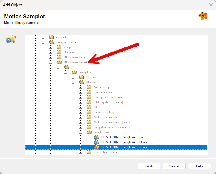

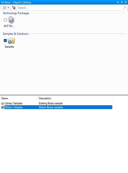

the motion sample importable from the toolbox object catalog (example ind AS4.12.8).
In the toolbox, when the “logical view” is selected select “Samples”, or type “Motion” into the search.
double click on the Motion Samples.
In the following window, select the single axis sample:
It could be, that you need to change the folder from “BRAutomaion” to “BRAutomation4”. It needs to be whatever folder your AS4 ist installed in.
When pressing “finish”, the task is imported into your project, inside whatever folder you selected in the logical view.

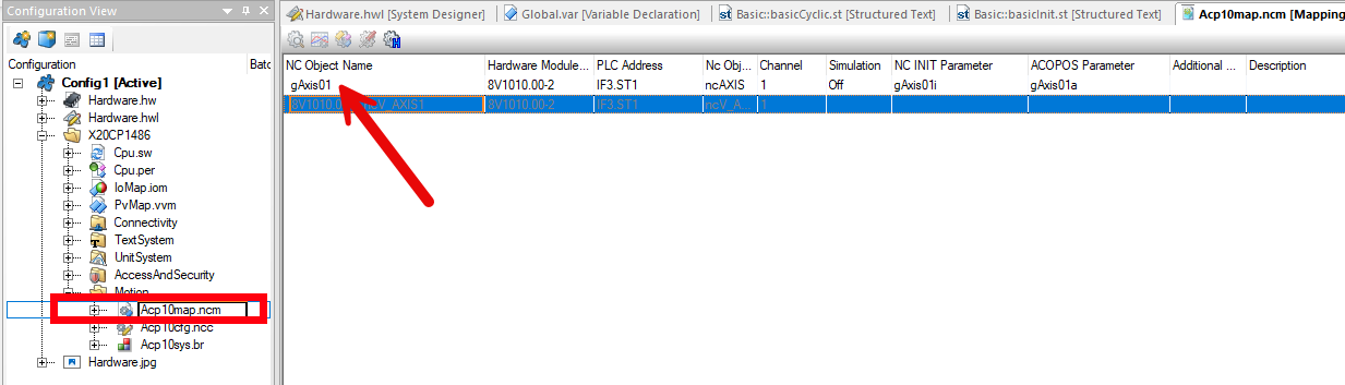

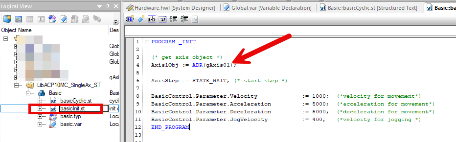

If you imported your acopos already, you will have a Acp10map.ncm File in the configuration view:
Open it and check the “NC Object Name” of your axis. This name needs to be the same as in the INIT part of the axis-sample:
If all of this is correct, you should be able to transfer the project, and in the watch-window move your axis.

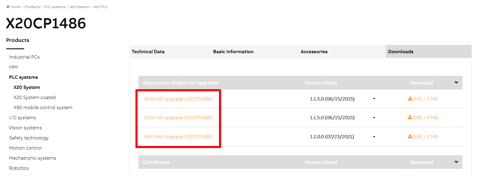

Depending on the Automation Studio Version you are using, you will need to download the corresponding file:
For example the CPU:
X20CP1486 | B&R Industrial Automation
You will need one of the three, depending on your AS Version,
  • AS2.6
  • AS3.X
  • AS4.X
AS6 is not an option, even in 4.X this CPU works only in “legacy” mode. I would recommend AS3.90.

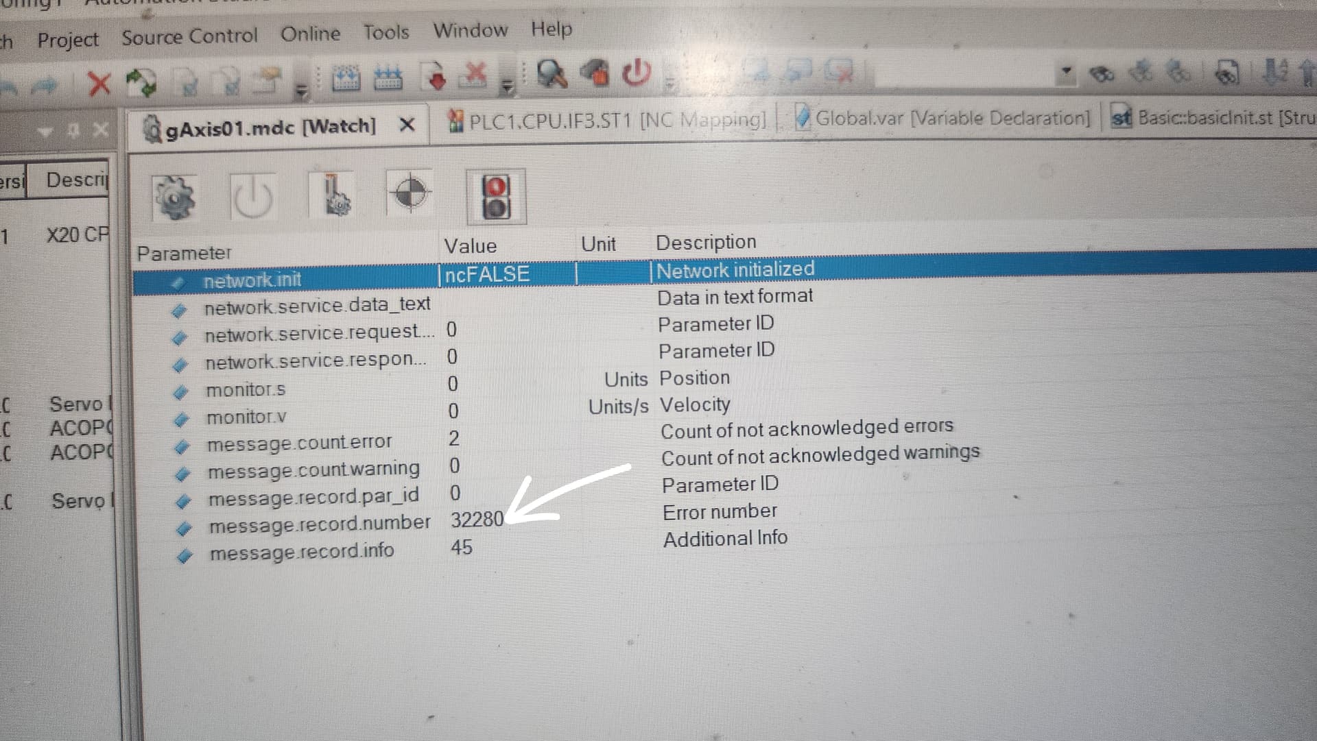

I did all the steps successfully in AS3.09 and I added the motion sample to my project as well as you described and transfered project to plc
Plc and acopos have connection via powerlink, But when I open watch window, Displays the following page and error code 32280
And in diagnostic manager window, I have red condition on Motion part And shows 2error code in alarm part respectively :32240 and 32280
Is it a software error related to parameters or variables or there is another problem? May you help me to troubleshoot this problem?

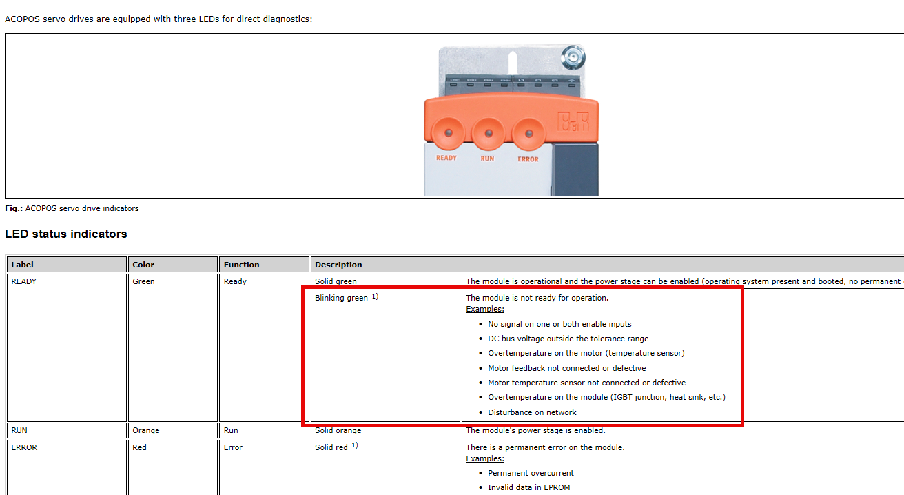

And drive Led indicate that “Network comunication active” (red led is on for 2.5s and off for 0.25s)

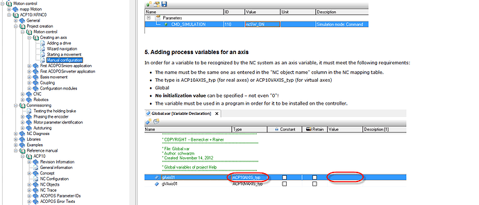

Maybe your process variable is initialized with a value? Like it says here, it cannot be initialized with any value, not even “0”.

And for third case, there is no value and it’s empty, but in v3.09 I just have one global variable(gAxis01) while in v4 there is two variable(gAxis01 & gVAxis01), in both case I have loaded Samples

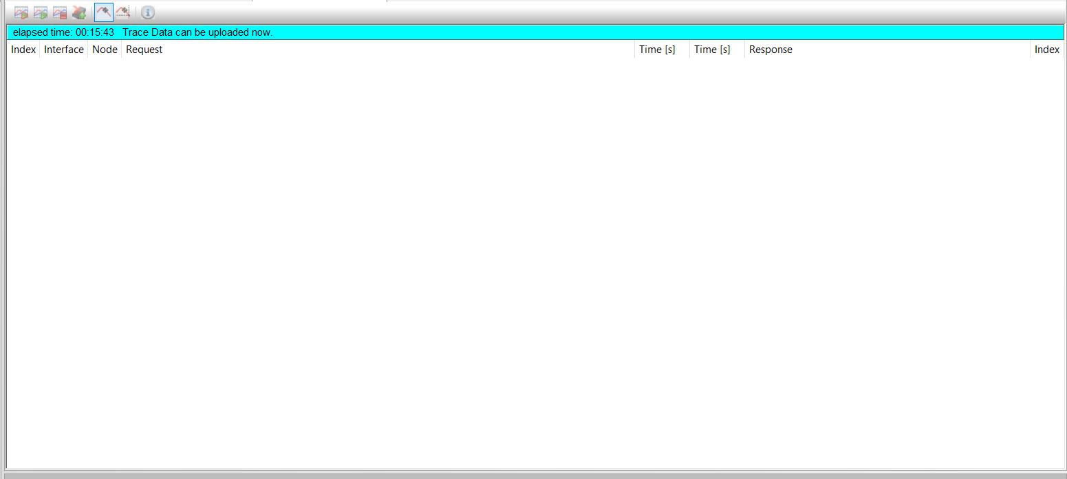

can you upload a network command trace?
B&R Online Help
start the machine, wait a few seconds so that the LED states do not change anymore and then save the data.

I tried to open network command trace, but opened page is empty like this and show no data:

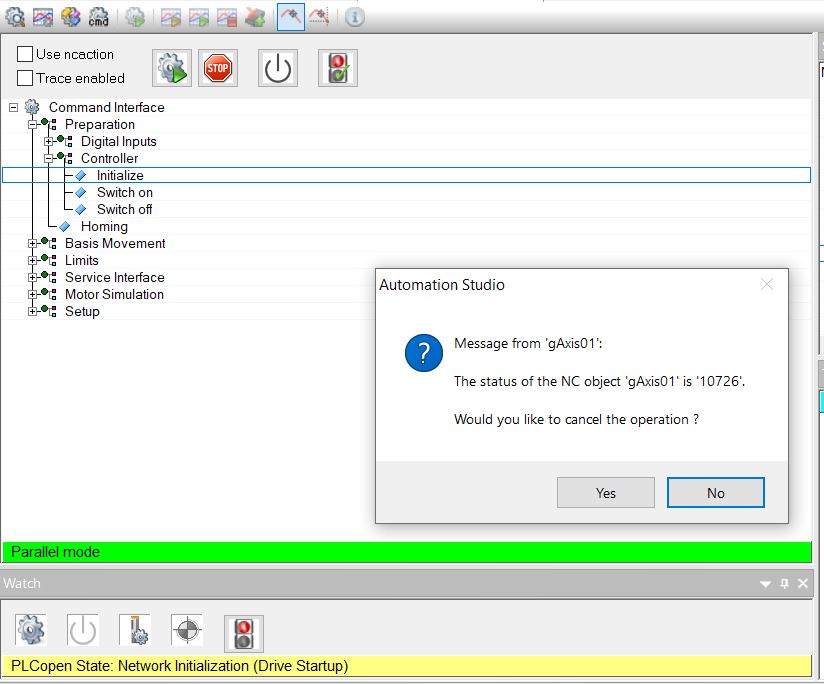

And in test window, when I try to execute any command I have this message:
when I click ‘‘No’’ it repeat again.

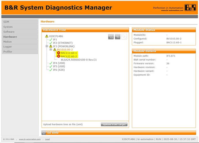

I checked hardware status in SDM,it seems both of option cards of acopos have error as shown in this screen:
For more confidence , I replaced drive and cards on a working machine and it worked without any problem.
it still looks like a connection problem…

What is the green LED on the drive doing?
Yes dear, I replaced my drive on a machine that have 4 acopos 1010 and b&r plc and it was working without any problem or error(but we have no access to machine plc program)
Green Led just blink once after power up, then it turning off.

On the network command trace, try right mouseclick and “load from target” or something like that. If there are any data, you should get it.
