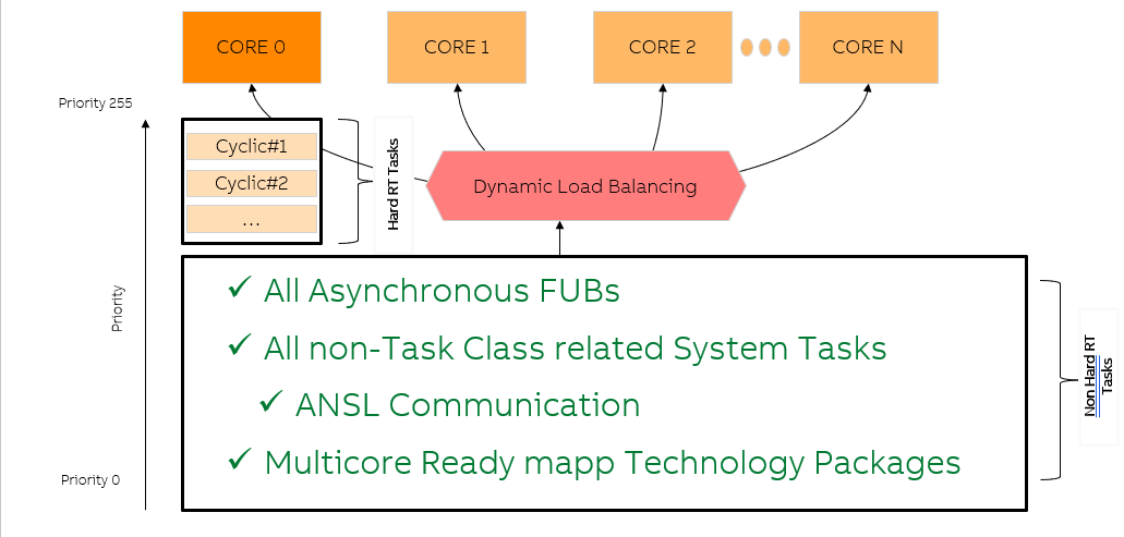

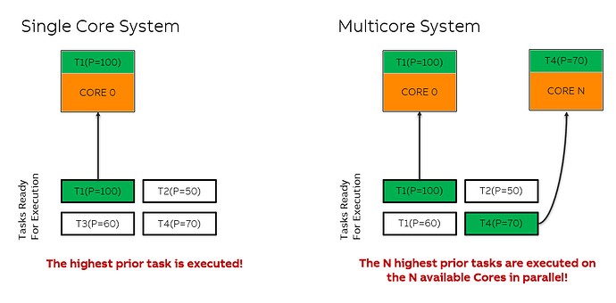

Runtime Architecture: From Single-Core to Multicore
Traditional Single-Core Execution
Tasks are queued and executed based on priority. Only one task runs at a time, limiting performance.
Multicore Execution Model
Tasks are distributed across available cores. Parallel execution of high-priority tasks is now possible. Dynamic load balancing ensures optimal CPU utilization.

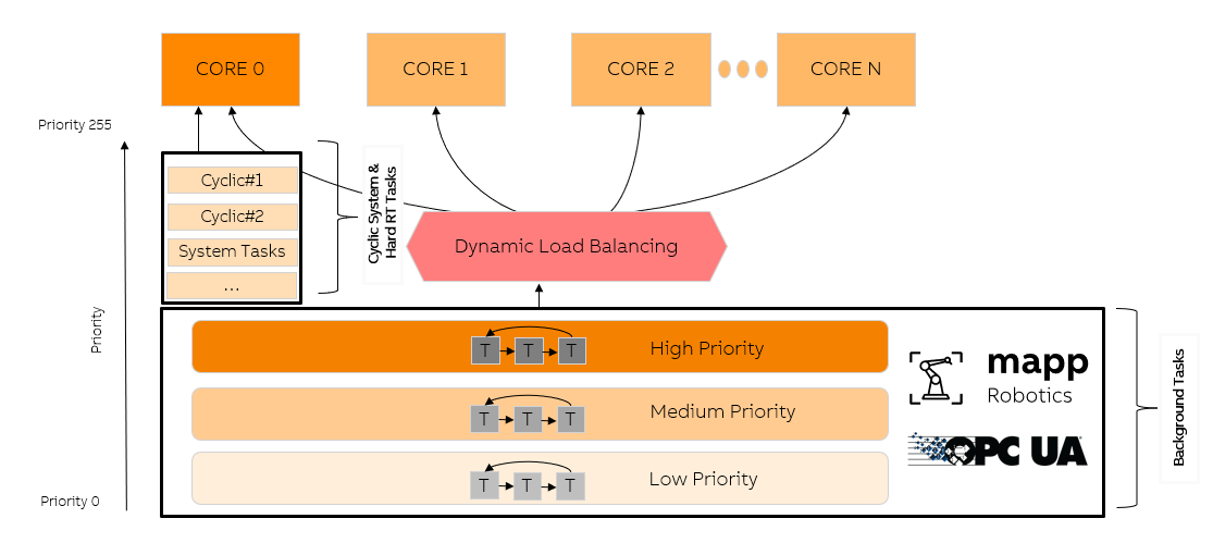

Runtime Integration
Automation Runtime API enables system-level multicore control. RT Class-based task scheduling allows fine-grained priority management. Background tasks are dynamically distributed across cores.
Technology Package Multicore Support
Multicore support is integrated into several key packages:
  • mapp View 6.1
  • OPC UA FX 6.1
  • OPC UA Client/Server
  • mapp Robotics 6.2
  • mapp Track (comming soon)
Tasks are automatically balanced across the least utilized cores, improving responsiveness and throughput. Tasks may be automatically migrated from one core to another at runtime based on system load.

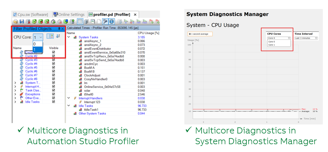

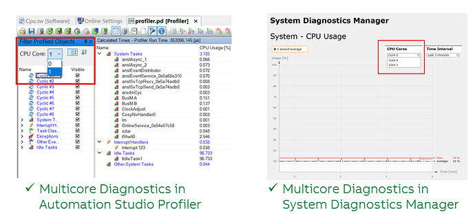

Diagnostics and Profiling
From AR 6.3 onwards:
  • System Diagnostics Manager (SDM) and Automation Studio Profiler provide visibility into core usage.
  • Developers can identify bottlenecks and optimize task distribution.

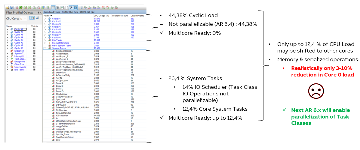

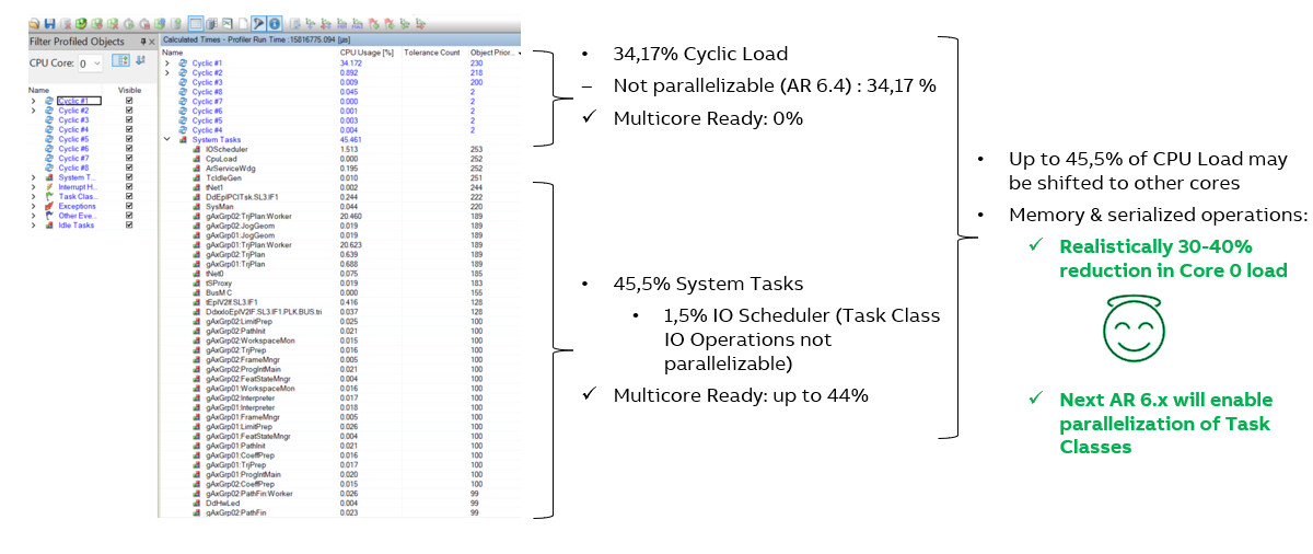

Case Studies
  • IO scheduler can not benefit from multicore processing
  • Task classes parallelization will come in one of upcoming AR version

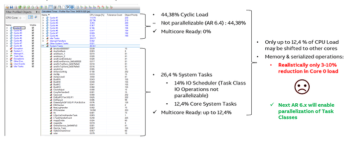

Unsuitable Project (AR 6.4)
High cyclic load (44.38%) not parallelizable. Only 12.4% of tasks could benefit from multicore. Minimal performance gain.
Suitable Project (AR 6.4)
45.5% of system tasks were multicore-ready. Real-world reduction of 30–40% in Core 0 load. Significant performance improvement.

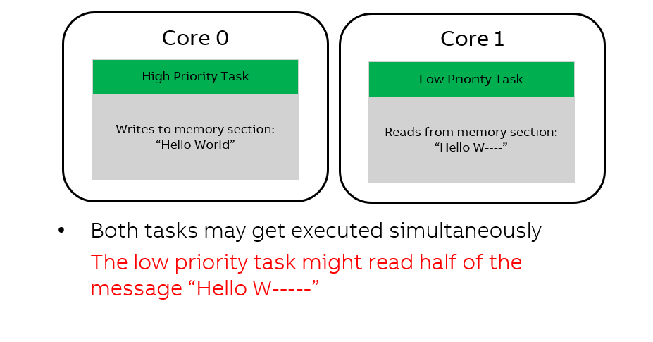

Application Code Considerations
Pitfall: Priority-Based Synchronization
On single-core systems, task execution is serialized. On multicore systems, simultaneous access to shared memory can lead to race conditions.
Solution: Use memory locks or synchronization primitives (e.g., AsSem Standard Library) to ensure data integrity.

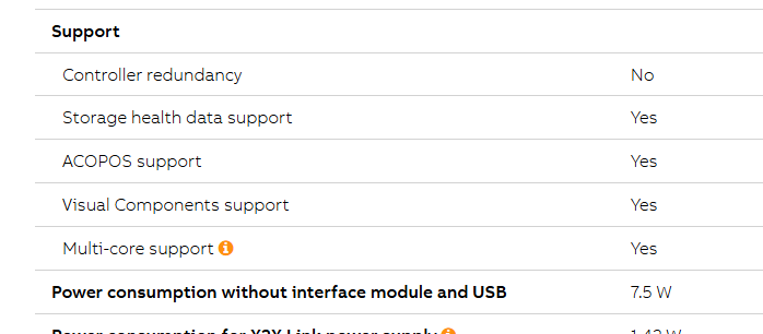

Where to find information if the PLC supports multicore? In the technical data table
As well as on our webpage, in the hardware details technical overview.
Example: https://www.br-automation.com/en-gb/products/plc-systems/x20-system/x20-plc/x20cp1686x/
