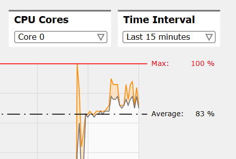

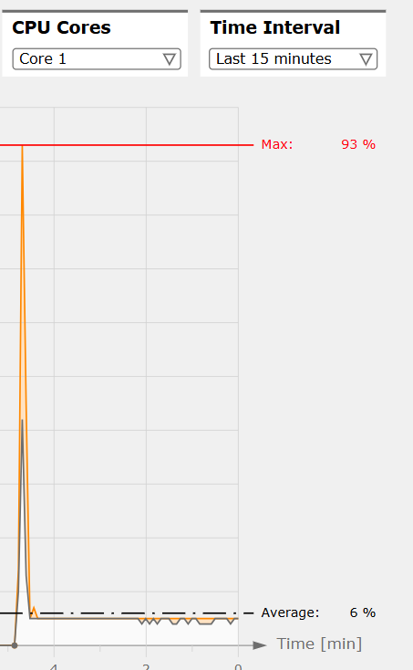

Thanks! It is just an statement. Recently I’m using automation studio 6 which have “multicore processing”, I was thinking that it can do it in “Task clsss or realtime class” but I think it is not ready yet.
Example:
Core 0:
core 1:
Above shows core 0 run 83% and core 1 run only 6%. If we can move more tasks to next core, it will be the best case. I think what I’m looking for is this:
But AR 6.X today never show such options. Or it is hiding somewhere that I never discovered.
you are right, this is not ready. this will come with one of upcoming version of AR/AS.
