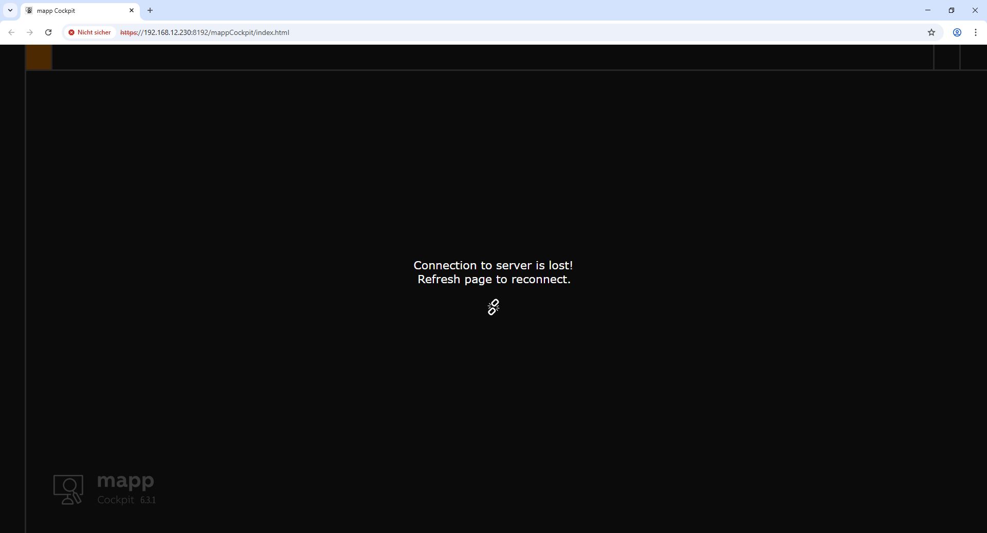

i have following problem (AS 6.3.1) I set up MappCockpit following the description.
In Simulation it is working fine. At the real PLC (PPC2200) it´s starting like expected but lossing connection after a few seconds.
I have OPC_UA activated, i have a User with Role BR_Engineer, PLC time is synchronius with LAptop.
Anyone had this state or any idea how to fix it.
This is an issue with mapp View 6.3 version. Please upgrade to 6.4 or downgrade to older mapp View version.
(mapp Cockpit uses the mapp View server in the background).

I /think/ the issue existed only in 6.3.1 and solved in 6.3.2 - at least it solved this or at least an issue with similar symptoms for me
https://www.br-automation.com/en/downloads/software/automation-studio/automation-studio-6/v60-tp-upgrade-mappview-6320/
But of course if 6.4 is the newest hot thing, why not use that
