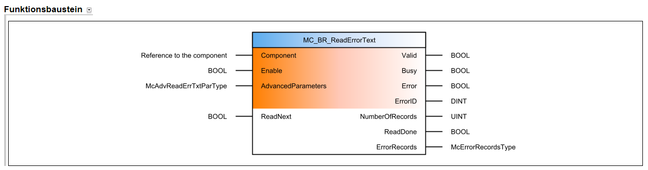

There are various ways of getting Error Information but this Functionblock i like most
MC_BR_ReadErrorText, it is part of the McBase Library.
You can use this functionblock for every Motion Component like Axis, AxesGroup, AcpTrack-Shuttle, …

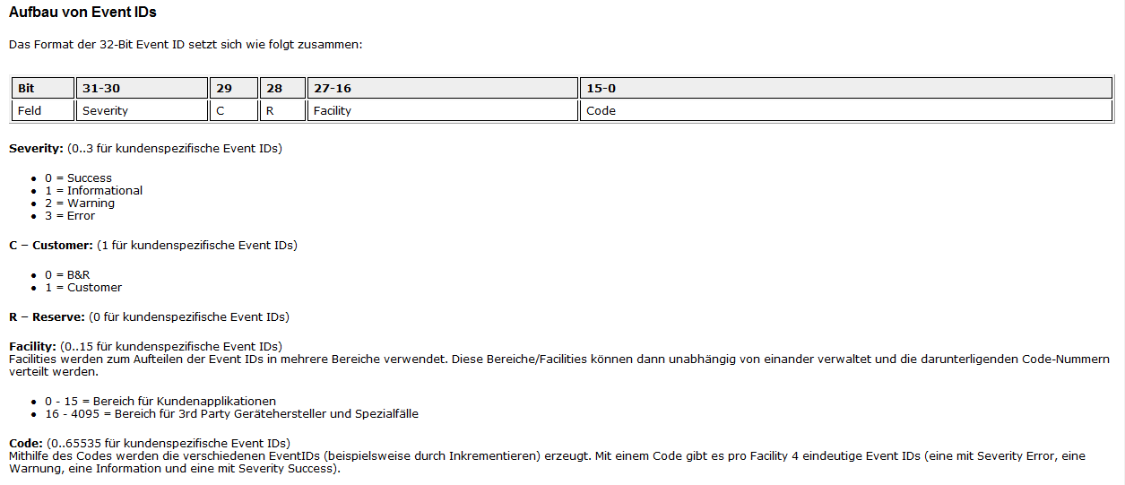

The older B&R Software used UINT as Error Codes, but as the time went and the eco system growed the Error Code system had been changed to the EventID DINT System.
If you get an ErrorCode in UINT it is basicaly a part of the EventID without the Information about the Facility and so on.
EventID
