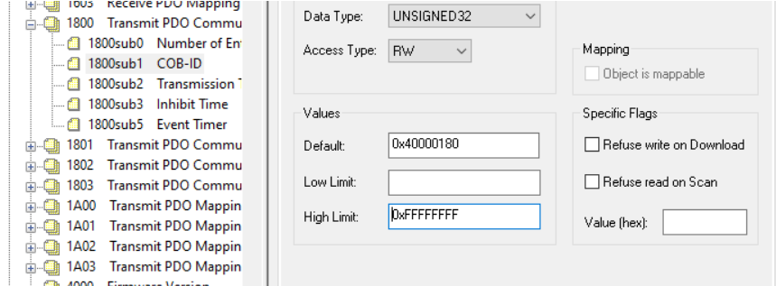

I’m trying to connect Schneider’s servo LXM28A via IF1041-1. AS will report following error.
What is the reason for this error? Is there a problem with the EDS file?

Can you share the EDS file ? It seems as the mentioned Object uses a non valid range and an EDS checker could clearify this
Thank you for your feedback.
I changed the High limit value of Channel 1400sub1-1403sub1 and 1800sub1-1803sub1 to 0xFFFFFFF.
Then the error disappeared.
