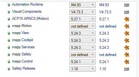

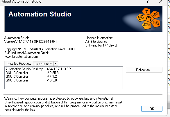

I have a small problem with the Polish characters (Ą, Ć, Ę, Ł, Ń, Ó, Ś, Ź, Ż) in mappReport. As you can see in the PDF files attached to this email, the Polish characters are replaced by dots …
In mappReport configuration, I have a choice of several fonts, but neither “Courier”, “Helvetica” nor “TimesRoman” works for Polish characters !!!
However, as you can see in the print screen of my mappView screen, the Polish characters are displayed perfectly in mappView!
For the record, the screenshot corresponds to the PDF I want to create!
Can I configure something somewhere so that these characters are displayed?

This help page specifies the characters that may be used. Unfortunately it does not seem to allow for the polish characters you are looking for.
If you need those anyway, I would try to request this as a feature with your local support team.
Best regards
According to help mpReport uses ISO/IEC 8859-1 (Latin-1)
https://help.br-automation.com/#/en/4/mapptechnology/mapp_services/mpreport/config/erklarung_der_konfiguration/einstellungen.html
