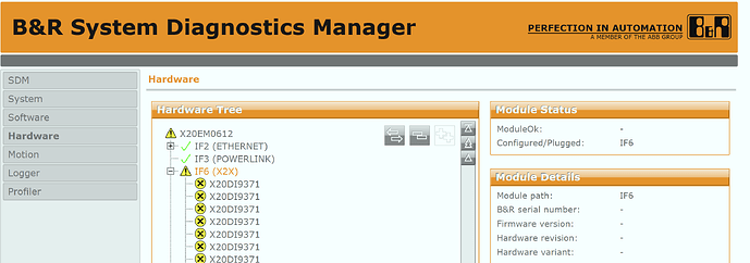

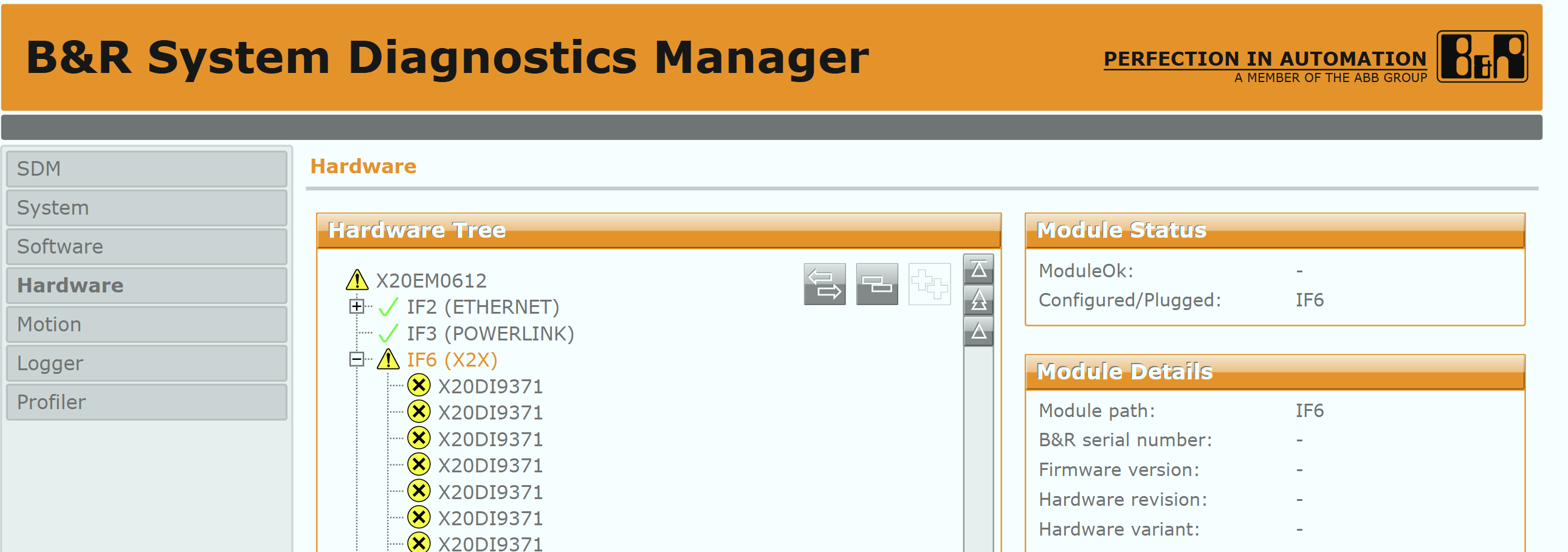

You can not partial download a project. When you have a flash card image it will have everything. If you create an empty project with just the hardware and download that you will basically wipe out the software and replace it with yours. I would go back and load the back into the machine. Try to open service diagnostic interface with a web browser.
Enter http://192.168.30.187/sdm/index.html replace the IP with the PP045. Check the tab hardware on the left and see if it gives you some clues.
Thank you very much for answering, regarding what you said Corne Geerts, if there is an X67PS1300 between the last X20BT9100 and the first X67 module X67AI4850, there is still no communication with the X67 modules.
Thank you very much for your reply, Stephan. I ran a port scan on the HMI PP045, and it didn’t have an open http port, only an FTP port. I don’t think I can do what you’re recommending.

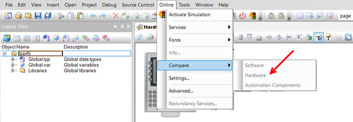

ok, when you are online with your Automation Studio please open the hardware compare and see if that shows any issues.

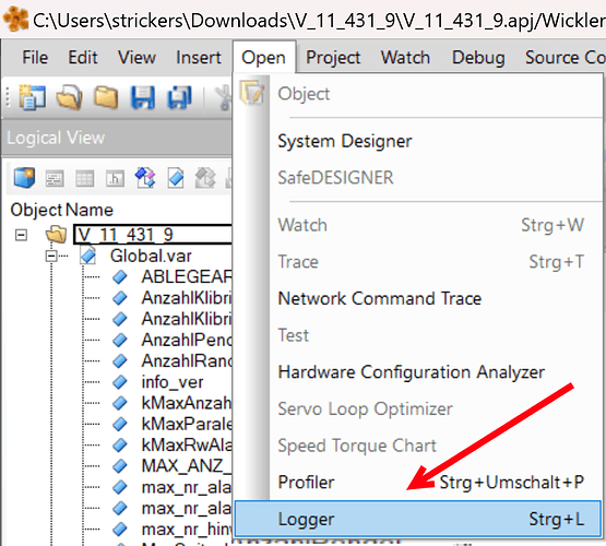

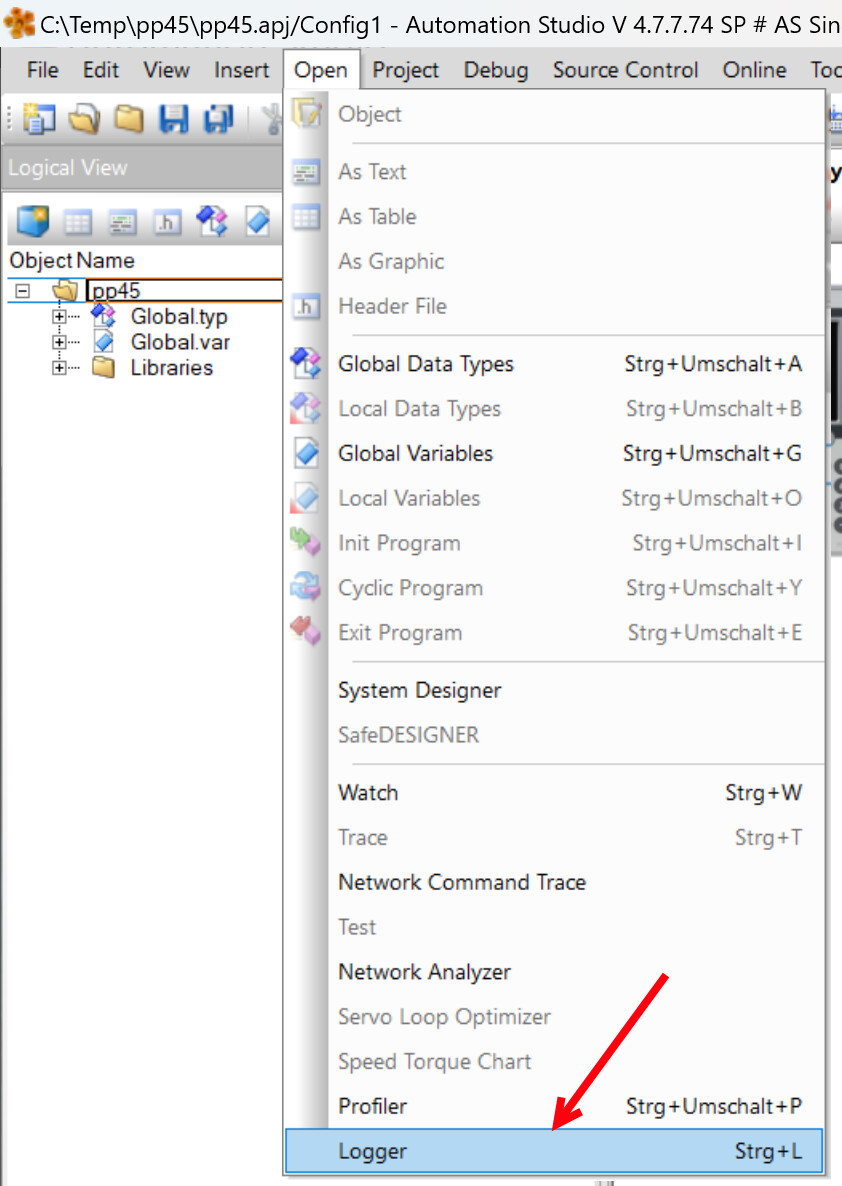

Also take a look at the PLC logger
Hi Stephan, thanks so much for helping me. I did what you told me, but the comparison doesn’t show any differences. I still can’t see the X67 modules. However, when I select the logger in the Info section, it says X2X link firmware update, firmware IF2.ST2 updated to V12.

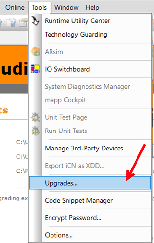

Hello everyone, I have a question in addition to the post. When I log in to the screen, it tells me: version k2.96 is not installed on this computer. H3.10 will be used instead. Could this be related to the problem?
These are the runtime version but that should not make a difference. You can download the older runtime via tools->upgrades.
