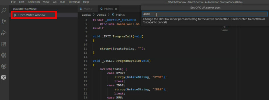

  • Variable Monitoring: Developers can monitor variables from multiple scopes (global, structures, function blocks) in a single watch window. This eliminates the need to switch between Automation Studio and Automation Studio Code during development.

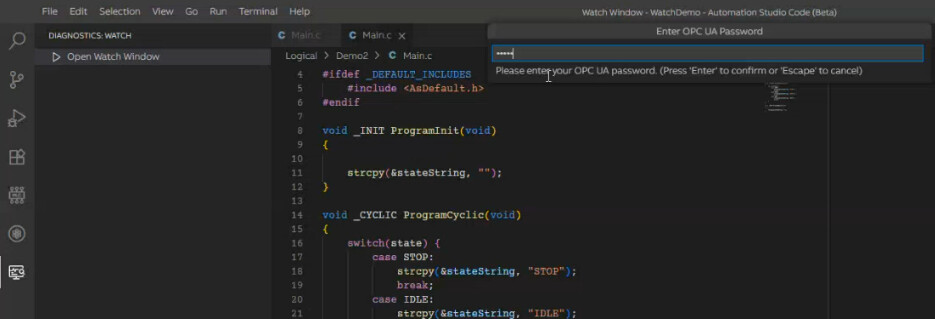

  • OPC UA-Based Communication: The extension uses OPC UA for secure communication with the target system. Authentication is supported via username/password or anonymous tokens, with credential storage handled by the IDE’s secret store infrastructure.
  • Live Values and Editing: The extension displays live variable values and, in development versions, supports writing to variables (enumerations, booleans, numbers, etc.).
  • Reordering and Persistence: Watched variables can be reordered via drag-and-drop, and the selection/order is persisted between sessions.
  • Performance: There is a current limit of 100 monitored variables to ensure optimal performance, including array elements.
  • Configuration Requirements: OPC UA client/server must be enabled, and exported data types set to “all” for full functionality, especially for enumerations.
Live Demo - Open Watch, establish connection using OPCUA and select PV for watch

Hi guys, I need some advice. How do I log out of watch window when I set it to remember my login and now it automatically logs me in? I want to log in as a different user.

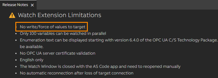

And I still can’t get write permissions even though my user is BR_Engineer
@phaehnel can you help colleague?
Writing is not supported in the currently available 6.4.0 version of Automation Studio Code Beta.
You can get to the Release Notes from the “Help” section of the menu bar in AS Code.

To remove stored credentials for the active target, use the command Watch: Delete Target Credentials. The next time you open the Watch Window, you’ll be asked to log in again. CTRL+SHIFT+P → Watch: Delete target credentials
