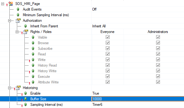

Dear Community Members,
When we enable Historizing, where the data logs are stored in contoller memory?
Can we change the storage location to USB drive, CF card or flash memory?
Thanks and regards

Hi, as far as I know historizing buffer is located in DRAM, so this mean that after restart stored value are lost. Location of the buffer is not possible to configure.
Thanks for the Clarification.
