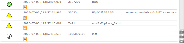

Unknown module 0x2fd7 (8BVI0110HWSS.000-4)
We are using the AS4.12.6.102 and we have to replace the ’ 8BVI0110HWSS.000-1’ to ‘8BVI0110HWSS.000-4’ due t the obsolescence
I have downloaded the exe and upgraded in the AS using the tools->upgrades->local and selected the ‘AS4_HW_8BVI0110HWSS.000-4.exe’.
from V4.6 HW Upgrade (8BVI0110HWSS.000-4) 2.3.0.1 (03/04/2024)
Replaced the module in the physical view configuration and rebuilt the project and run it on the target. I am getting the below error when i checked it in the logger.
‘unknown module <0x2fd7’
Any help appreciated to fix this issue.
Thanks.
What is the PLC Address of the 8BVI0110HWSS.000-1 module? The logger item that you are referring to points to SS3.IF1.

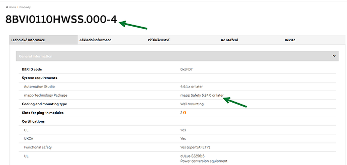

The 8BVI0110HWSS.000-4 needs mapp Safety 5.24.0 or later; see B&R website.
Hi thanks for your reply,
Yes the module is at SS3.IF1.ST4

According to the screenshot, you are using Safety Release 1.7, a.k.a. Safety Legacy.
Based on the technical data already shared from the B&R website, you have to upgrade to at least mapp Safety 5.24.0.
