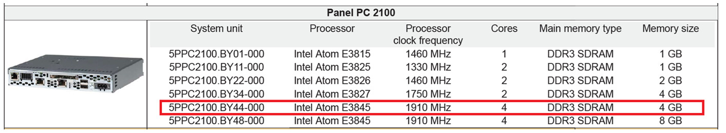

Is it possible to upgrade the memory on a Panel PC 2100 from 4GB to 8GB?
I currently have the 5PPC2100.BY44-000.
No, the only swappable component on a APC or PPC2100 is the CFast card. All other items are not field changable.
