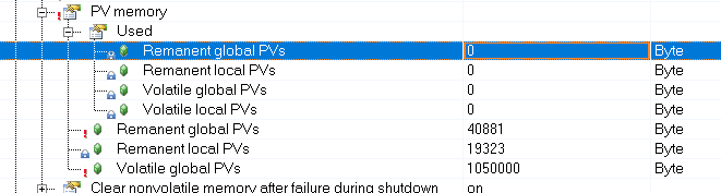

  1. Storage area of permanent variable ‘strLifetime’ exceeds size of storage area for permanent variables
  2. Storage area of the CPU for permanent variables is too small for all permanent variables
errors are coming after rebuild, fyr
Permanent variables are not supported on C80, so you have to change it and make the variable remanent or store it in the data module. In my application, I have done so far, I have never relied on remanent variables for many reasons. But this is about application design.
The length of UserRAM + RemMEM exceeds the maximum of 64000 bytes
As I know I couldn’t be able to change or edit Used memory size.
Then how should i resolve this memory exceed issue,
any program needs to change, or any option is there?
Please share any reference or help me to solve this issue.

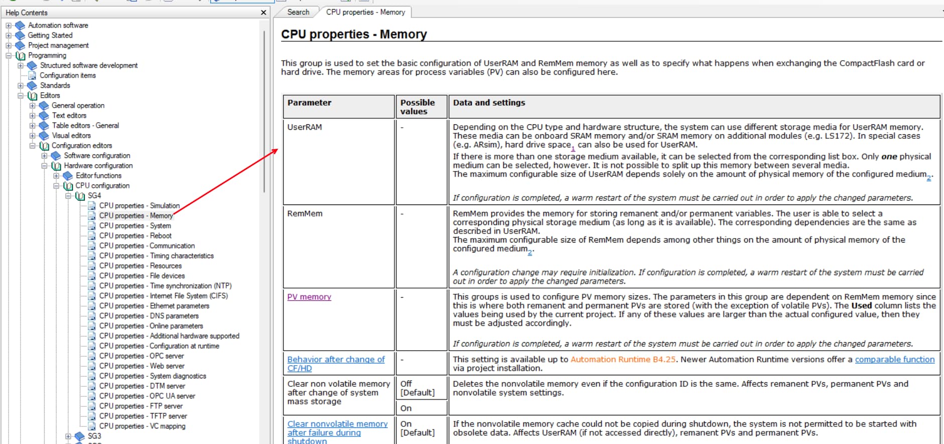

To help you with this we would need a project, so help from Community point of view is limited.
More info here, sorry for printscreen, this page is missing in online help:
