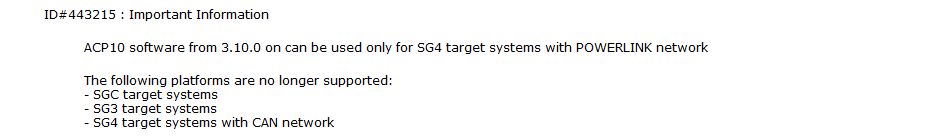

The Hardware is Supported in AS3.0.90 and it should be possible to use it there.
About the Version of the ACP10 i would recomment to stay on the highest 2.x Version. As i think the 3.10 was one of the first 3.x Versions and up there CAN is no longer supported for Motion-Communication.

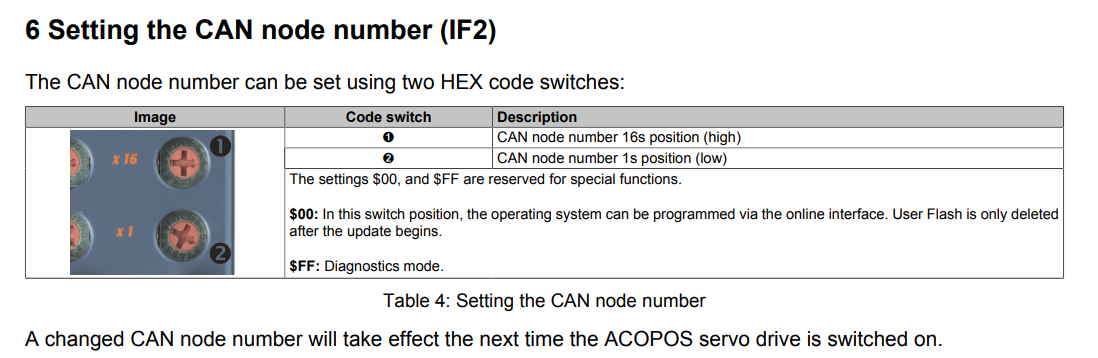

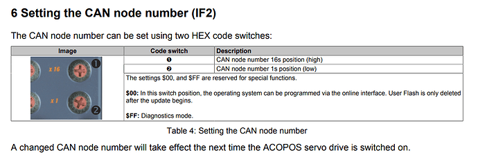

please make sure you have the exact module variant in your AS project.
If not, a wrong AR will be transferred to module/CF and it will not boot.
Check the CAN node number switches, they must be different from $00 and $FF because that are special boot modes (see Data sheet).
