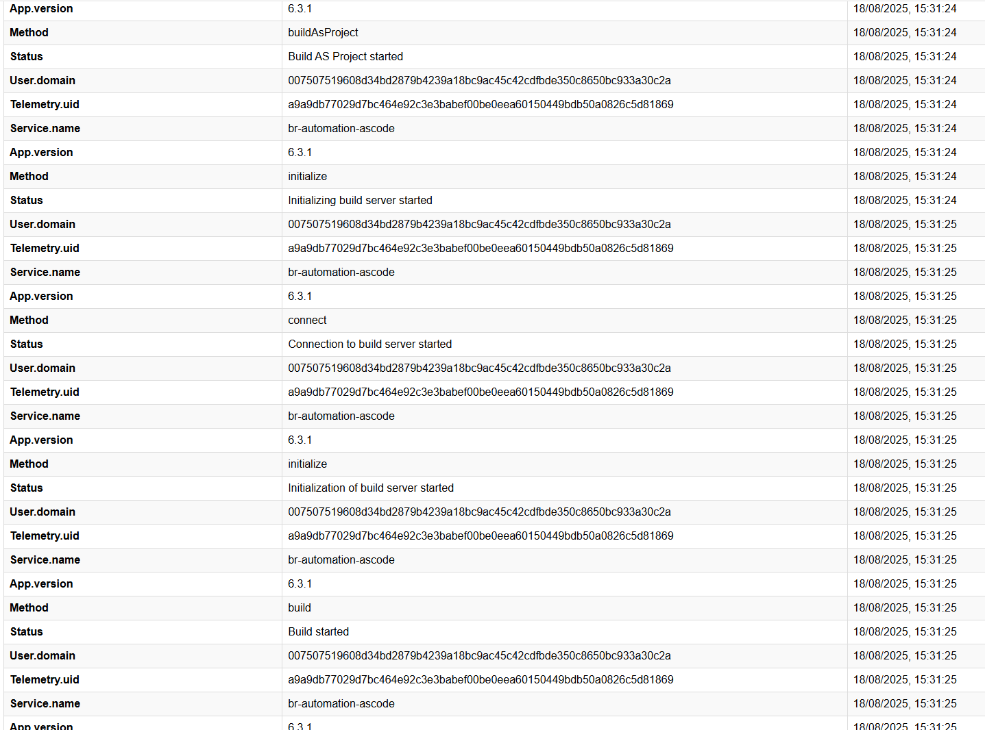

In the telemetry data you should find these entries:
(Can be found in C:/Users//.br-automation/ascode/telemetry/

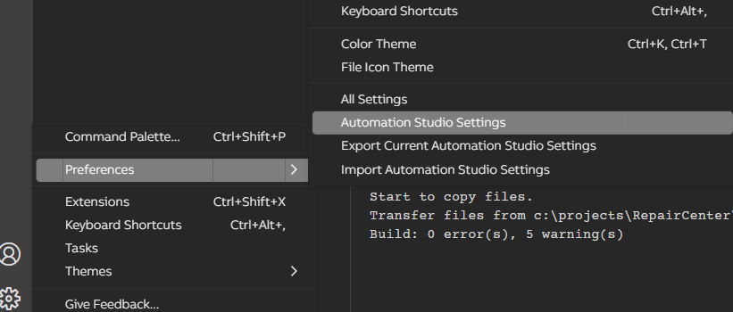

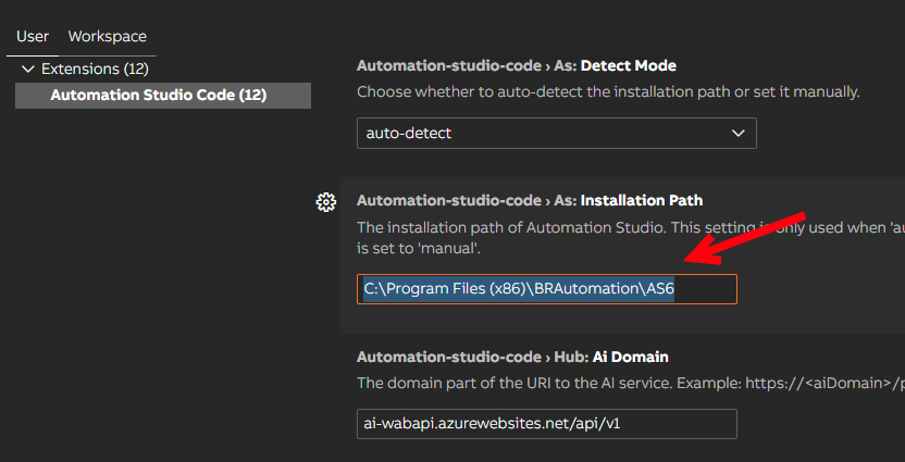

Another thing to check would be if AS Code installation is correctly linked to AS6. For that check the preferences like this:

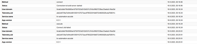

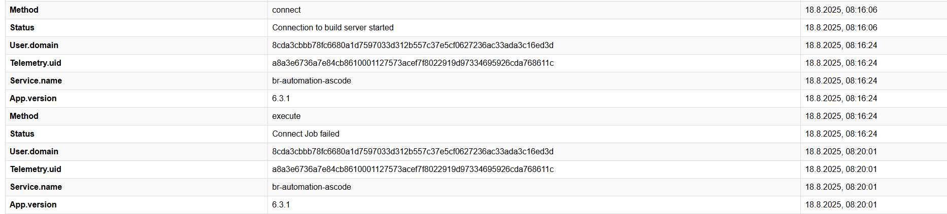

No, the service does not start.
On C:\Program Files\BRAutomation\Automation Studio Code\resources\plugins\automation-studio-extension\as-build-server I can find the buildServer exe.
The telemetry data says: connect job failed
I have already checked the installation path in the settings.
Nothing is running on port 28000 for me. Should the build server be running constantly here? Or only when building is in progress?
