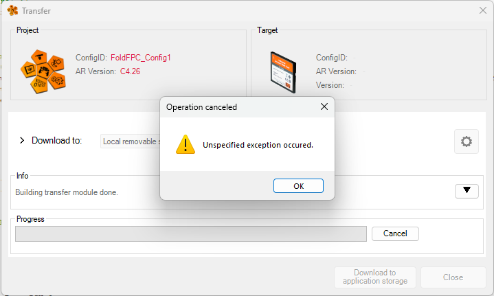

Windows error 1460 when making CF card with AS4.2 and AS4.12
Has anyone found a solution to windows error #1460 when making a CF card?
I don’t get it all the time, but often/always accompanied by the windows message that the file system on the CF card needs to be checked
When it happens AS needs to be closed, and it will often forget to close PVI manager, so I close this manually. Restarting AS fixes it for a while

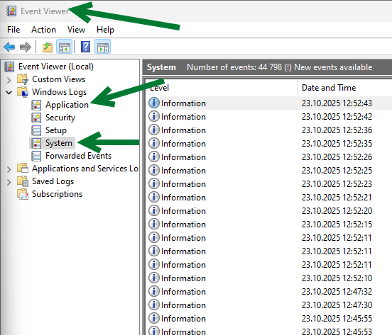

Is it always the same CF card since it’s accompanied by the message “CF card needs to be checked”? Do you start AS with admin rights?
I’d check the Windows Event Viewer for details.
You can also get suggestions by consulting Windows error #1460 with AI tools.

Is there anything in the Windows Event Log?

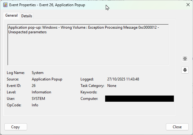

I tried to reproduce what was a consistent problem and can only generate a new one. My colleague has found a third
Mine now gives:
Event viewer gives:
My colleague has found a problem with F4.03 which always worked OK for me:
Event viewer gives:
All of these errors keep repeating, so every other CF card, or one in three

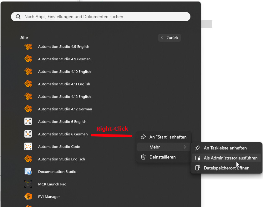

i have no deeper knowledge about the CF-Card and Windows Errors. I do get them sporadicaly. My Workaround is to explicit tell the System to start AS as Administrator.
After i did this i never had issues.
You might give it a try if you did not allready do this.
Thanks Michael, I have set mine the same and I’ll report back in a week or two

Marked this as solved as we have had no further occurrences since running as administrator - thanks Michael
In fact, AS has been much more stable since running as admin - before that crashes were quite frequent
