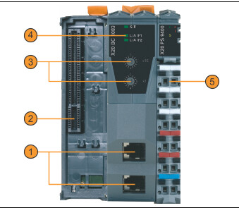

as far as i understood you need more Option-Card Slots in less space. I think this is a bit Difficult.
On this slide i have the overview of existing Sizes which are compatible to the X20-IO Mounting on the right side of the PLC.
The Compact Class is smaller but has less cumputational Powers, so its only an option if the X20CP1585 was not used to its full power.
The EM-Size only offers 1 Slot.
If you need the Option Interface for additional Fieldbus Communication it may be an option to place it after a X20BC1083 Extentable Buscoppler. Here you have up to 2 Option Slots placed behind a Powerlink Interface. They are reduced in their Communication Bandwith, but can offer an alternative.
Please let us know which additional options you would like to place to your existing PLC.
