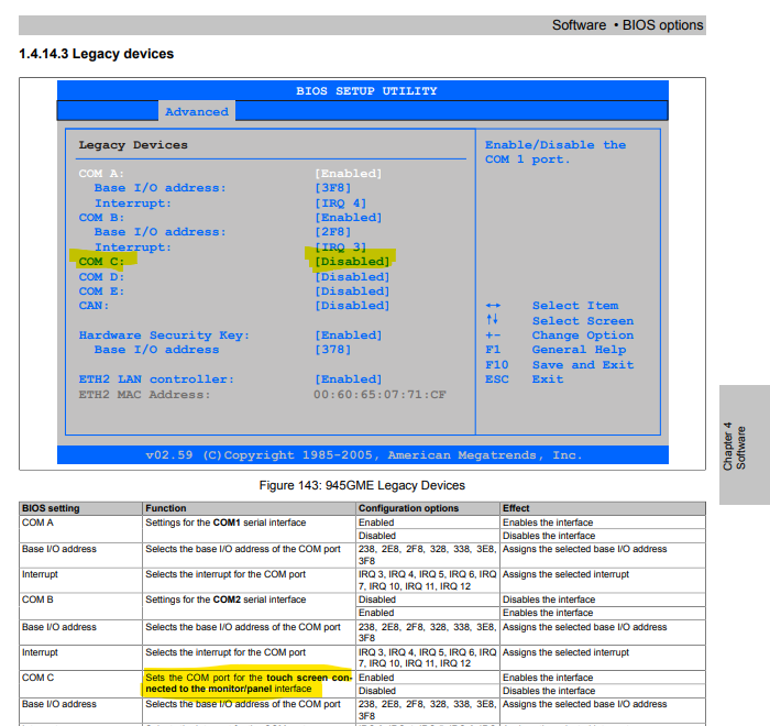

which processor board you’re using? On the material sticker on the device, the order code should be listed beginning with 5PC800.Bxxx-yy (for example, 5PC800.B945-10).
Knowing this order code, it’s easier to find the right documentation / user manual.

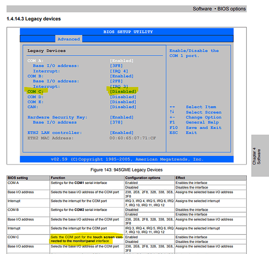

I would check first in the BIOS of the APC, if the internal interface “COM C” is enabled - this interface is the COM-Port used via SDL to communicate with a serial touch device.
I’m not sure if the BIOS setting is everywhere the same with all different 5PC800.B - boards, but I would first take a look into “Advanced → Baseboard / Panel Features → Legacy Devices” - if there’s a COM C entry and it’s disabled, please enable it.

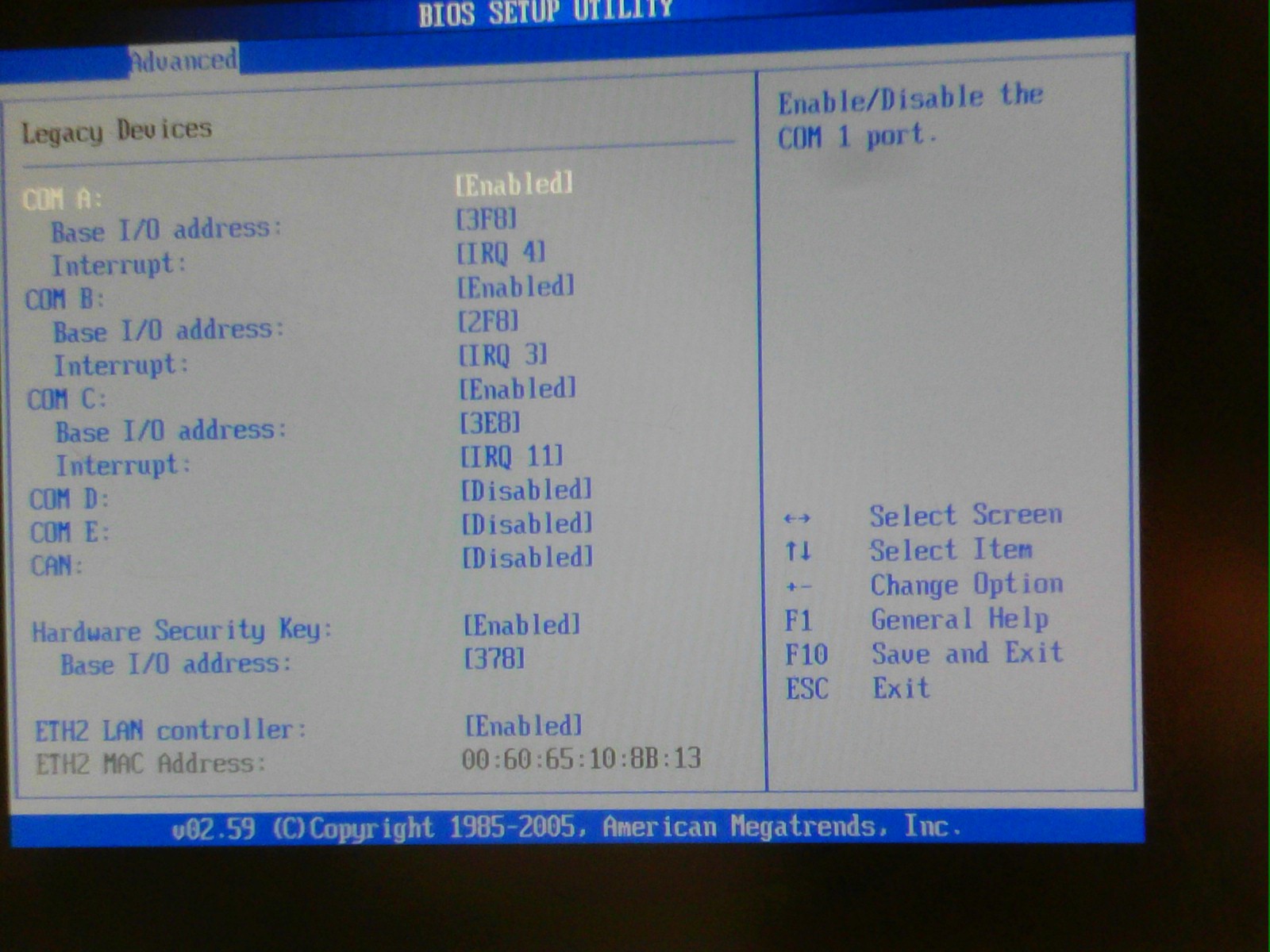

IS 5PC810.SX02-00 my processor board were else would it be listed?
the 5PC810.SX02-00 is just the baseboard.
But your picture shows already, that the COM C is enabled, so as I know that’s all that can be checked.
