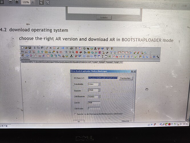

Dear Sir, I uploaded the variable list and module for the IF260. However, the manual instructs me to download a suitable AR system to the new CPU. Where does this operating system come from? How can I find a suitable operating system? Thank you!
I followed the manual step by step, but when it comes to downloading the operating system, I don’t know what to do. Where can I find the right operating system? The manual doesn’t explain it, and I don’t know where to find it. Please help me, thank you!

Yes, sir. I need an operating system for CP153 V201. Could you please help me check if there is such an operating system? Thank you very much!
A CP153 does not work “standalone” - there is memory plugged into this PLC
The operating system is placed on this memory which is called (for example) ME953 - you need to know which memory is plugged in this PLC
Here is V201 for all available PLCs including the CP153 memory units
System.zip (3,8 MB)
