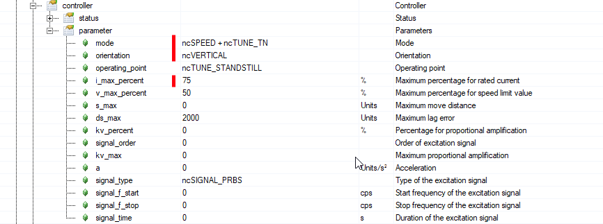

i am not an expert for vertical axes, but i will give it a try.
I went in the ARsim and used Simulation “Complete” to have the possibility to test the Autotuning vs. the simulated Load Model.
Then i opened the “Test” Window to set up the Tuning for the Speed Controller.
To get an Integral Action part you have to enable the Option-Bit “ncTUNE_TN”.
As it was told it is an vertical axis, i used “ncVERTICAL”.
It is important that the Current Limitation must be increased to an amount where the axis is able to hold the load. Use “i_max_percent” with a value high enought.

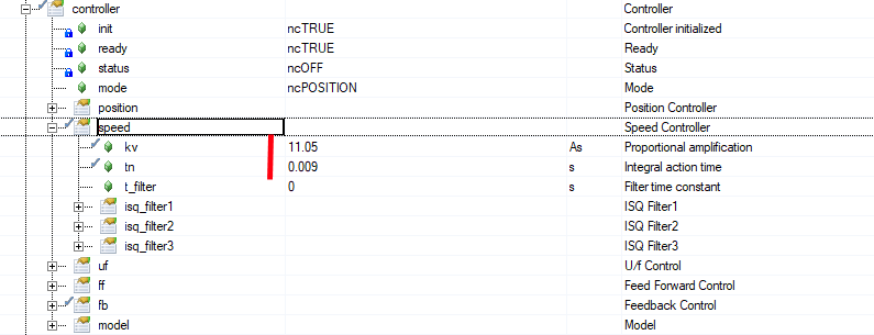

The Tuning gives a Speed “kv” and “tn”.
I did not adjust the defaul load model (just to save time), so i think there is no external force set up in this quick simulation test. But i think this would be the way to go.

Hi Michael,
Thank you for the hints. It seems that I overlooked some important details regarding the tuning parameters. Now it looks much clearer and easier.
Michal Malek
