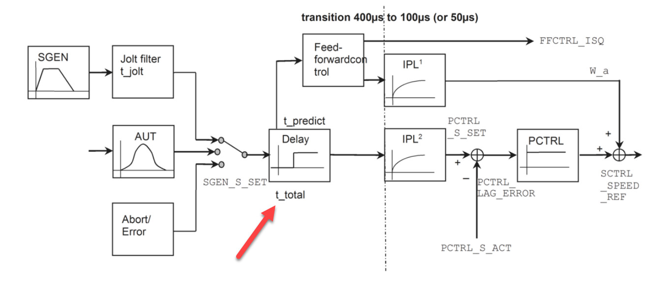

The core currently calculates a path in which all axes arrive at the target point at the same time. Is there a possibility that all axes move with the maximum settings specified by the optimizer and thus no longer arrive at the destination at the same time?
I can imagine the situation were the axis are in different networks and/or the parameters
POS_CTRL_T_PREDICT and POS_CTRL_T_TOTAL
are not well configured.
For instance, one drive has a different parameter that the rest, and this one arrives always late in comparision with the other 3.
B&R Online Help (br-automation.com)
Other option, is that the drives are in different POWERLINK networks :exploding_head:
