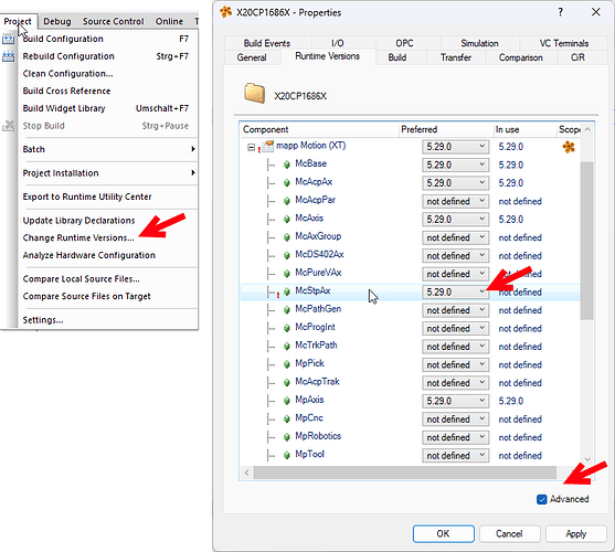

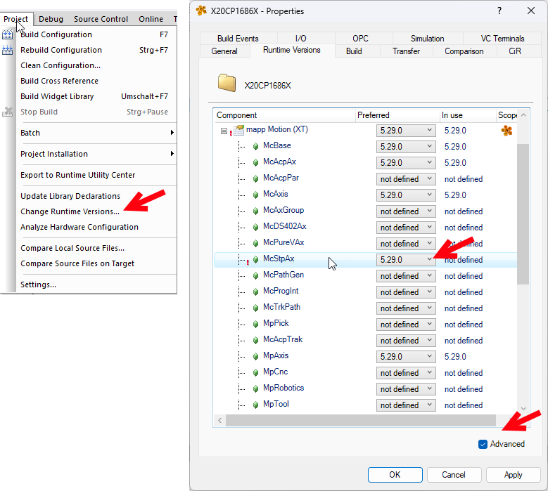

My first bet would be that the McStpAx Library might be missing. This library is needed for all X20/X67SM Modules. But the AS likes to miss this dependency.
Please check in the Change Runtime Versions Settings if the Library has a version selected.

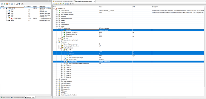

Thanks for your quick reply. I have already installed the McStpAx 5.29.1 and after that only i got the error. I am attaching the screenshot of the logger with errors for your reference. I have also set the timing as EPL/X2X interface, and interface is X20EM0613:IF3; Cycle time is 2000 microsec, Thanks in advance

Please check vs. this Screenshot
Please consider that after a Transfer of this changes a restart of the plc has to be executed.
Thank you very much for detailed explanation. The timing value was the issue. Now the motor is able to power on and rotate. Also can you kindly say where i can see the remedy or actions to be done for the errors i am getting in the logger? Here B&R Online Help i am only able to see the description of the error but cannot see the actions to be taken.
