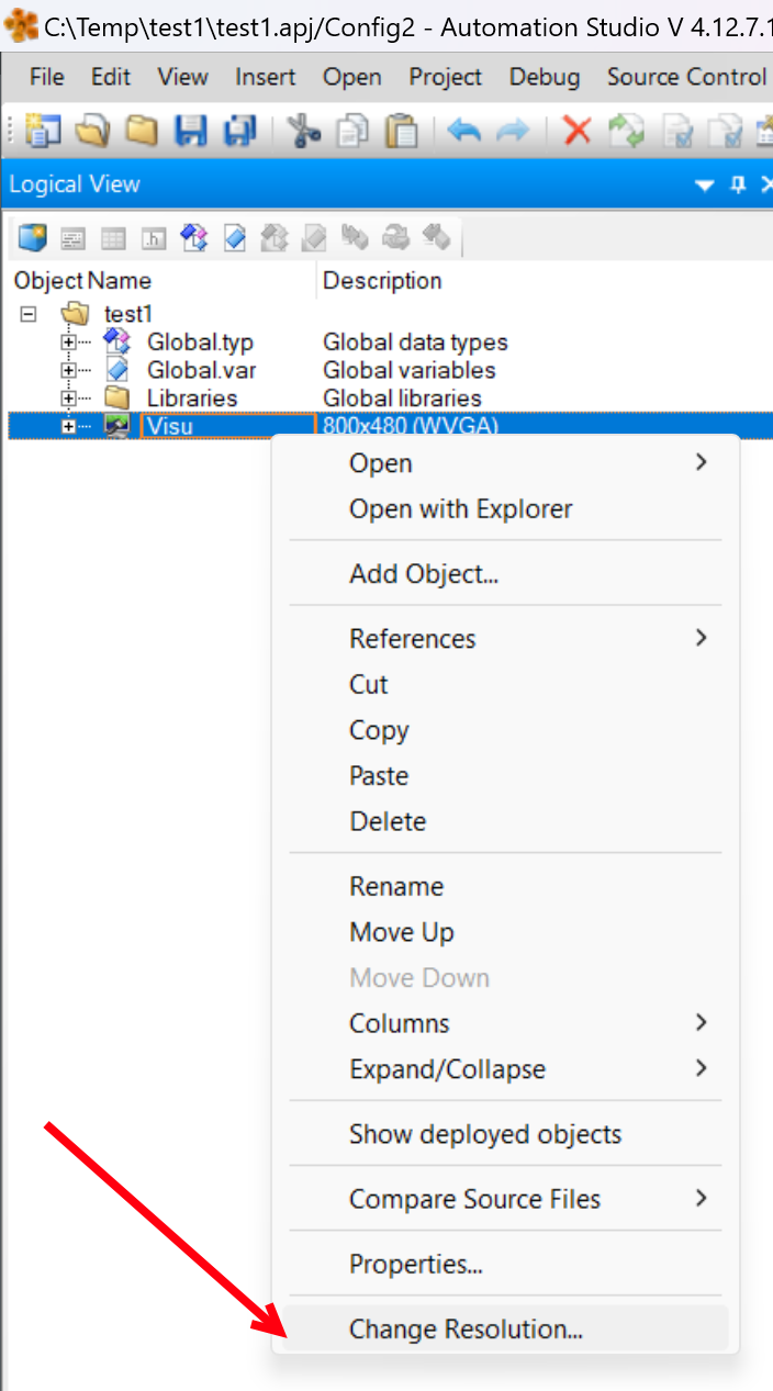

Have you thought about using a C30 or C70 panel. There are smaller 4:3 options there if cut out is not an issue. It might also be better from cost perspective. Also keep in mind that there is an option to change the resolution in VC4 where you can choose between different conversion options when the ratio changes. There might still be some widgets that you have to adjust but it will get you good portion of the way.
              Thanks Stephan, none of those go big enough at 4:3 unfortunately
I will give the change resolution option a go when we have decided which way to go
