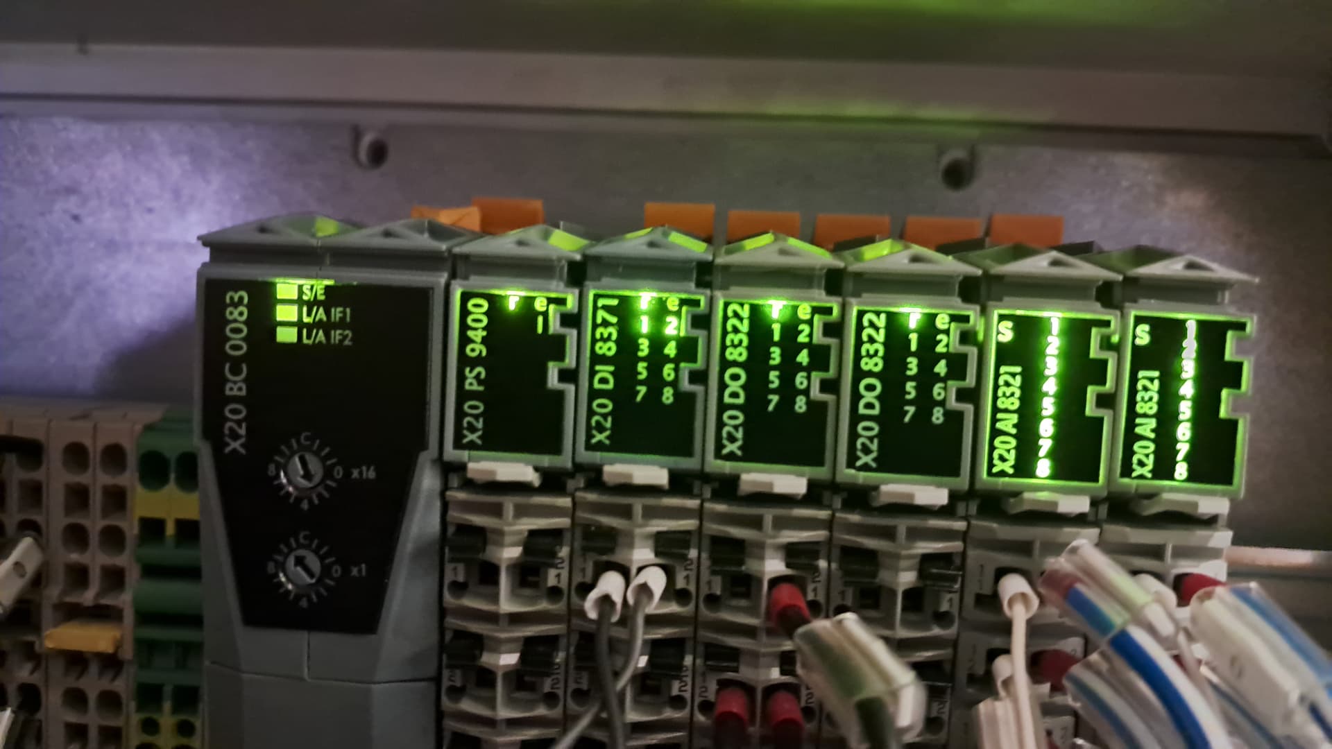

I have problem on my machine relate with B&R X20 system
This is my first time I handle B&R, the problems are X20 BC0083 blinking on SE (red) and X20 PS9400 on r indicator go red and then green again at same time
And it happen at randomly
I already replace X20 BC0083 card + backplane, X20 PS9400+ backplane, the input voltage range 23.5-24 VDC
Can you help me what happen on my problem and how to solve this?
Thank you
Hi Gatra,
it’s hard to say what the issue is from just the lights. It looks like both modules go into pre-operational. Maybe there is an issue with your Powerlink cable.
  • Is this a new problem, did the machine work before?
  • What is the frequency of the issue?
  • How do you fix the issue when it occurs?

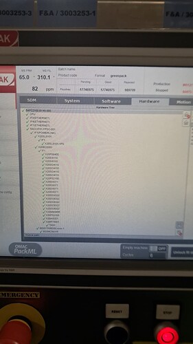

I’ve done to separate the power for XB link and I/O like on manual book X20 PS9400, try to make sure the input voltage upper 23.5 vdc when running too but still blinking on card
I check on hmi when alarm occur, no fault on hardware tree, still normal
Try to increase the voltage to 25V on the power supply. In the image above there should be a tab “Logger” next to Motion. Can you take a look what it says on that page.
Ok now we set on 24.5 vdc
Logger page just like this, how to read it?
Click on View or Upload and then open it in a text editor

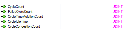

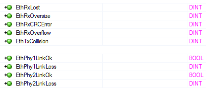

There are some diagnosis I/O datapoints in the I/O mappfing of the PLK IF card and the X20BC0083:
PLK IF:
X20BC0083:
Just enable the monitor mode and tell us the values. Maybe this will get us further.
