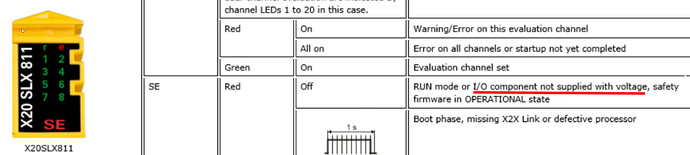

  • Do you have transfered the grey Automation Studio Project and do you have a online Connection to your grey PLC active in your Automation Studio?
  • Is the grey PLC in Mode RUN?
  • Does the IO-Suppy have 24V for the X2X Backplane the X20SLX806 is connected to?
It depends on the Supply Module (X20PLC, X20Buscoppler, X20Busreciever) how the IO-Supply is supplyed. But this has to be present that the X20SLX is working.

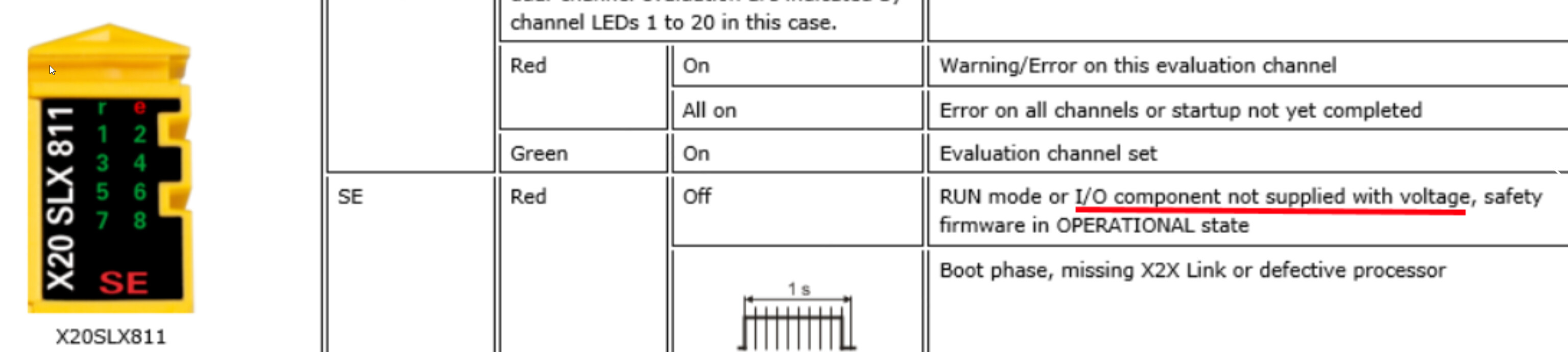

Below one of my mistakes I put on the top on my “don’t do that again!“:
I was not able to connect to my SLX because I didn’t connect (as Michael said) 24V to 24 V I/O. In my mind it was enough to apply 24V to the CPU, yup just in my mind.
If you use SLX next to EM cpu:
don’t forget to connect 24V to 24V I/O connector otherwise even you see LED on SLX you can’t connect to that:
Ciao
Valerio
i already have that, but i think theres a problem with SafeDESIGNER Communication Settings!
