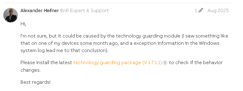

Automation Studio Task Manager opens and closes after a few seconds. I uninstalled and reinstalled the program, but it didn’t work. I even formatted my PC, but it still didn’t help. I don’t understand why. How can I fix this?

@eem.ferhat I see one input from @alexander.hefner that is not in your list of things you did:
  • as @alexander.hefner wrote in the comment, Do you see any exception information in the Windows system log?
I downloaded and installed the Technology_Guarding.exe file, but it didn’t work.

Try to open Evet Viewer in Windows. Try to run Automation Studio, and see if any errors appear in Event Viewer ?

Do you have the latest version of CodeMeter installed and do you see an active license container there?

Hello, I uninstalled Automation Studio and installed the latest version, AS4.12.6.106. It was previously installed on this computer and I was able to use it. I don’t have an enterprise license; I was using a 90-day trial. I uninstalled Codemeter and then reinstalled Codemeter.
I installed version 8.40b. There is no active license container.
I am using the free AS version.
There is nothing to select regarding the dongle in TechnologyGuard. I think it’s related to Codemeter, but I don’t understand.

  1. Try if you are able to connect license server : https://technology-guarding.br-automation.com/gatewaysExt/
    You should see this. If you are not able to see license server, then check antivirus or firewall.
  1. Check if the Codemeter Runtime Service is running
  1. Check if you have cofigured right Server IP :
New Servername: brateggevapp12.br-automation.co.at (IP: 10.43.12.134)
  1. Try to delete old license :
DeleteLicense (2).pdf (54.2 KB)
I’ve reviewed what you said, but I can’t access the CodeMeter web administration section and I can’t run the CodeMeter command in services.msc; it gives me error 1053. I’ve researched this and tried to fix it, but it hasn’t worked. Can you help me with this?

Thank you for your information. Hello, CodeMeter is already stopped in the services.msc directory, meaning I cannot run stop or similar commands. I also couldn’t find anything in the file at C:\ProgramData\CodeMeter\CmAct. I encounter the same problem when trying to start it. How can I solve this CodeMeter problem?
Sincerely
Did you try uninstall CodeMeter from your PC then uninstall AS. Then reinstall AS from scratch he should reinstall CodeMeter correctly?
Yes, I tried that too, but it didn’t work. I’m in a dead end.
